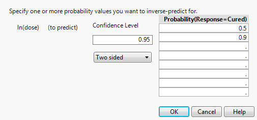

7. Click the red triangle next to Logistic Fit of Response By ln(dose) and select Inverse Prediction (Figure 8.11).
8. Type 0.95 for the Confidence Level.
9. Select Two sided for the confidence interval.
10. Request the response probability of interest. Type 0.5 and 0.9 for this example, which indicates you are requesting the values for ln(dose) that correspond to a 0.5 and 0.9 probability of being cured.
Figure 8.11 Inverse Prediction Window
11. Click OK.

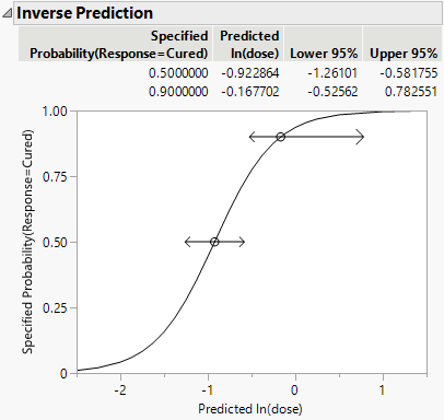

The Inverse Prediction plot appears.
Figure 8.12 Example of Inverse Prediction Plot
The estimates of the x values and the confidence intervals are shown in the report as well as in the probability plot. For example, the value of ln(dose) that results in a 90% probability of being cured is estimated to be between -0.526 and 0.783.
