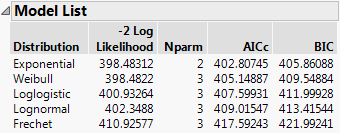

14. Click the Cumulative Damage red triangle and select Fit All.
Figure 5.3 Model List Report
Model List Report
From the Model List report, you determine that the best fitting distribution is the Exponential distribution.

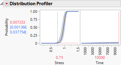

15. In the Results report, scroll to the Exponential report.
16. In the Distribution Profiler report, set the current value of Stress to 0.75.
17. Set the current value of Time to 10000.
Figure 5.4 Distribution Profiler for Exponential Distribution at Specified Settings
Figure 5.4 shows that the predicted probability of failure for a test unit under constant stress of 0.75 at 10000 time units is 0.007233, with a 95% confidence interval of 0.001368 to 0.037754.
