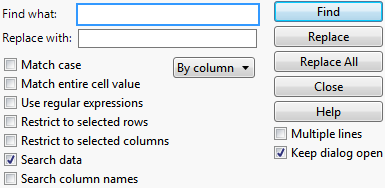

You can find and replace cell values by selecting the Edit > Search > Find options.
Figure 4.20 The Find Window
The Find Window

Find Window Options
Refine your search with the following options:
Match Case
Performs a case-sensitive search, which can be useful for locating proper nouns or other capitalized words.
Match entire cell value
Detects empty spaces, which lets you search for a series of words in a character column, or locate strings with unwanted leading or trailing empty spaces.
Tip: To find missing character values, leave the Find what box empty and check Match entire cell value. To find missing numeric values, insert a period into the Find box and check Match entire cell value.
Use regular expressions
Assumes the find string to be a regular expression instead of the literal string that you enter in the Find what box. The regular expressions follow standard semantics.
Restrict to selected rows
Restricts the search to selected rows.
Restrict to selected columns
Restricts the search to selected columns.
Search data
Searches only data cells (omitting column names).
Search column names
Searches only column names (omitting data cells).
By column
Searches the table column by column, from top to bottom, until it reaches the last cell in the rightmost column, or until you stop the search.
By row
Searches the data table row by row from left to right, to the rightmost cell in the last row or until you stop the search.
Multiple lines
Increases the Find and Replace boxes to 3 lines long instead of 1. The Enter key inserts a return into the field.
Tip: You can alternatively click and drag on the Find and Replace boxes to make them larger. If you copy and paste, the boxes resize to 1 line long, but all of your text is still there.
Keep dialog open
Keeps the Find window open during your search.
