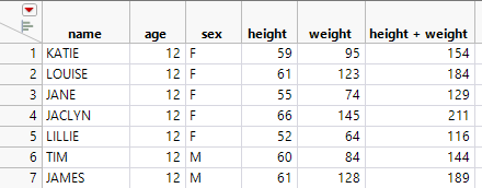

For example, consider a data table with a simple sum as shown in Figure 2.11. The column height + weight has a formula. The formula adds height and weight by row for all rows in the data table.
Figure 2.11 Data Table with Formula ColumnĀ
