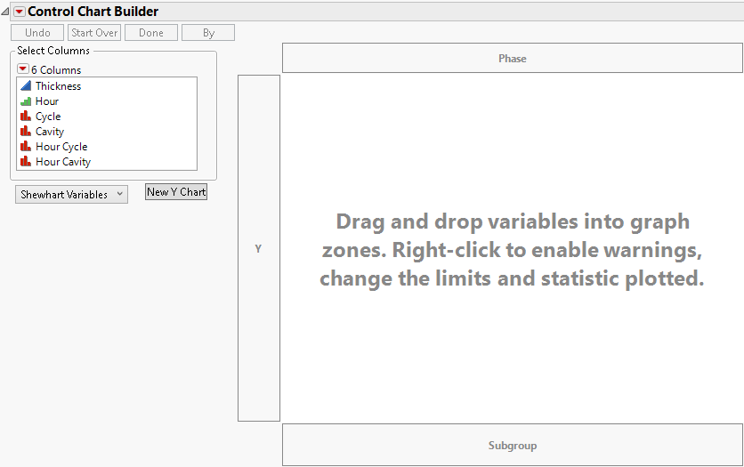

Figure 3.4 Interactive Control Chart Builder Window
To begin creating a control chart, drag variables from the Select Columns box into the zones. If you drop variables in the center, JMP guesses where to put them based on whether the variables are continuous or categorical. The Control Chart Builder workspace contains the following zones:
Y
Assigns the process variable.
Subgroup
Assigns subgroup variables. To define subgroup levels as a combination of multiple columns, add multiple variables to the Subgroup zone. When a subgroup variable is assigned, each point on the control chart corresponds to a summary statistic for all of the points in the subgroup.
Phase
Assigns phase variables. When a Phase variable is assigned, separate control limits are computed for each phase. See also XBar and R Chart Phase Example.
