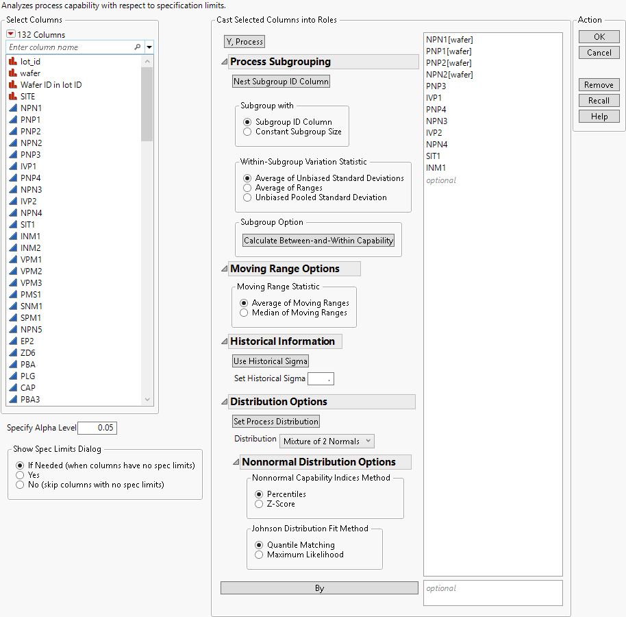

Launch the Process Capability Platform by selecting Analyze > Quality and Process > Process Capability. In Figure 7.6, which uses the Semiconductor Capability.jmp data table, all outlines and panels have been opened.
Figure 7.6 Process Capability Launch Window
The Process Capability launch window contains the following outlines and options:
• Process Selection
• Process Subgrouping
• Moving Range Options
• Historical Information
• Distribution Options
• Other Specifications
