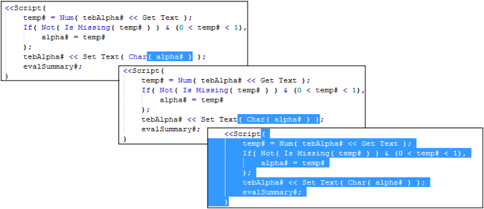

• If you put your cursor within an expression and press Ctrl+] on Windows (Command+B on macOS), the entire expression is selected. Fences that enclose the expression are included. Repeat this process to highlight the next-higher expression. Figure 4.6 shows an example.
Figure 4.6 Each Step in Matching Fences
