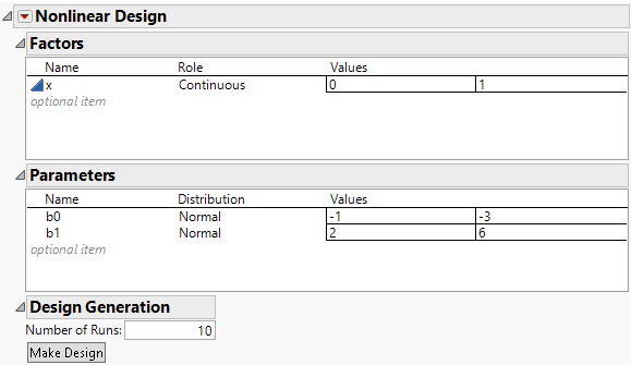

The initial design window shows the Factors, Parameters, and Design Generation outlines.
Figure 23.16 Initial Design Window
