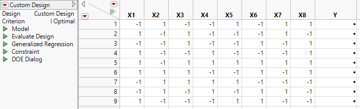

Click Make Table to construct the custom design data table. In the Custom Design table, the Table panel (in the upper left) can contain scripts, as appropriate given your design. The Model, Evaluate Design, and DOE Dialog scripts are always provided. To run a script, click the green triangle next to the script name. If your design includes covariates, the design table includes a covariate row index column unless all covariate rows are used in the design.
Figure 4.26 Custom Design Table Showing Scripts
Possible scripts include the following:
Model
Runs the Analyze > Fit Model platform. The model described by the script is determined by your choices in the Model outline and by the type of design.
Evaluate Design
Runs the DOE > Design Diagnostics > Evaluate Design platform. The model described by the script is determined by your choices in the Model outline and by the type of design.
Constraint
Shows model constraints that you entered in the Define Factor Constraints outline using the Specify Linear Constraints option.
Disallowed Combinations
Shows model constraints that you entered in the Define Factor Constraints outline using the Use Disallowed Combinations Filter or the Use Disallowed Combinations Script options.
DOE Dialog
Re-creates the Custom Design window that you used to generate the design table. The script also contains the random seed used to generate your design.
