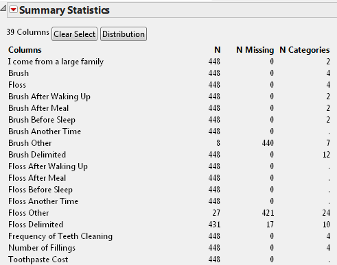

The Columns Viewer gives you a quick view of data table characteristics. For example, the Summary Statistics report shows which columns contain missing values. You can select those columns in the report and then exclude them in the data table.
Figure 4.12 Identify Missing Values
The Summary Statistics report shows the following information:
• the total number of rows (N)
• the number of rows with missing values (N Missing)
• the number of categories (N Categories)
• for continuous data, the Min, Max, Mean, and Std Dev

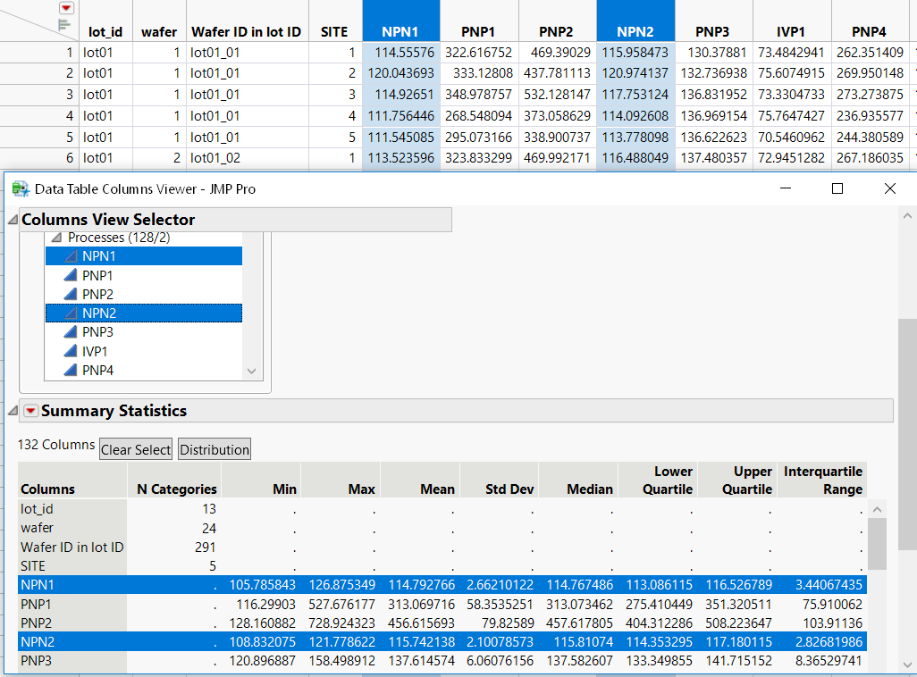

Creates a linked Summary Statistics report for the selected columns. Right-click to select options such as sorting by column or creating a data table. Select Show Quartiles to include lower quartiles, upper quartiles, and interquartile ranges. To create a linked data table from all columns in the report, click the Summary Statistics red triangle and select Data Table View.

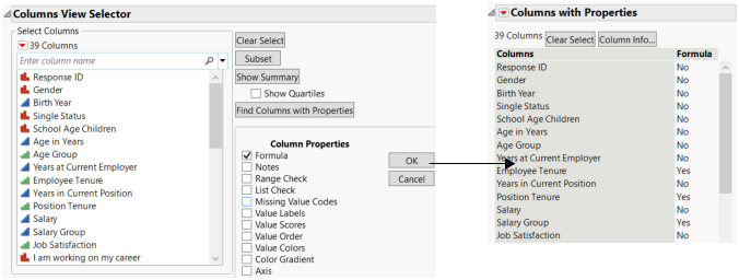

3. Select Find Columns with Properties, select Formula, and click OK.
The Columns with Properties report appears. Several columns include the Formula property. Because the list is so long, you want to view all formula columns together.
Figure 4.13 Select the Formula Column Property

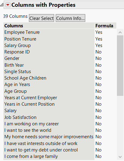

4. Right-click the report, select Sort by Column, Formula, and then click OK.
Columns that have a Formula property appear at the top of the report.
Figure 4.14 Sort by Column
Sort by Column
5. Select the Employee Tenure, Position Tenure, and Salary Group columns and select Column Info.
Formulas for the selected columns appear in the data table’s Column Settings window.

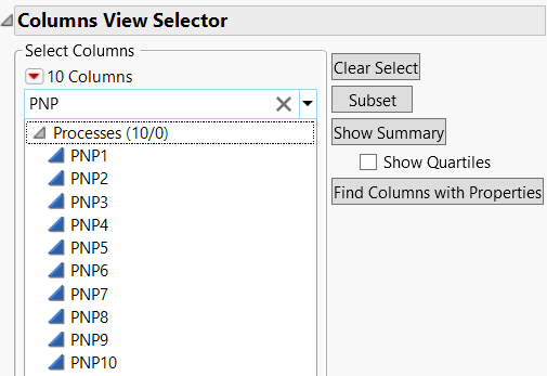

2. Select Cols > Columns Viewer to open the Data Table Columns Viewer window.
3. Type PNP in the box and press Enter.
The grouped processes are shown.
4. Expand the processes group to show the PNP columns.

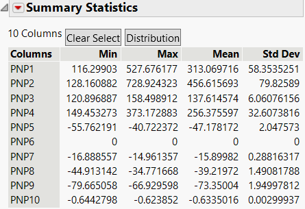

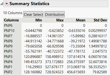

5. Click Show Summary to add the Summary Statistics report.
The rows show the minimum, maximum, mean, and standard deviation for each column.
Figure 4.16 Summary Statistics for Selected Columns
6. Right-click in the report and select Sort by Column.
7. Select Std Dev and Ascending, and then click OK.
Notice that PNP6 has no standard deviation, because the minimum, maximum, and mean values are 0.
