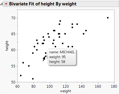

To select a point in a graph, click the point. This selects the point as well as the corresponding row in the current data table. To select multiple points, press Shift while you select points. A point’s label appears when you place the cursor over the point with or without clicking.
Figure 9.18 Label for a Data Point
