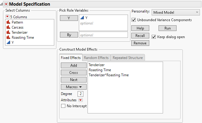

1. Select Help > Sample Data Library and open Split Plot.jmp.
3. Select Y and click Y.
4. Select Mixed Model from the Personality list.
5. Select Tenderizer and Roasting Time, and then select Macros > Full Factorial.
Figure 8.27 Fit Model Launch Window Showing Completed Fixed Effects Tab

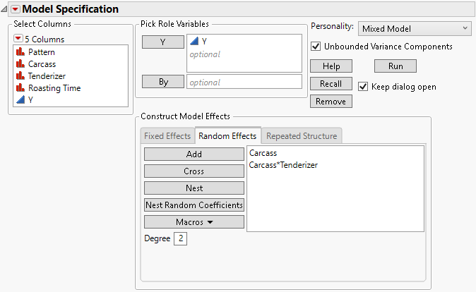

6. Select the Random Effects tab.
7. Select Carcass and click Add to create the random carcass effect.
8. Select Carcass and Tenderizer and click Cross.
The Carcass*Tenderizer interaction is the error term for the whole plot factor, Tenderizer. This is equivalent to the Carcass*Tenderizer&Random term in Standard Least Squares.
Figure 8.28 Fit Model Launch Window Showing Completed Random Effects Tab

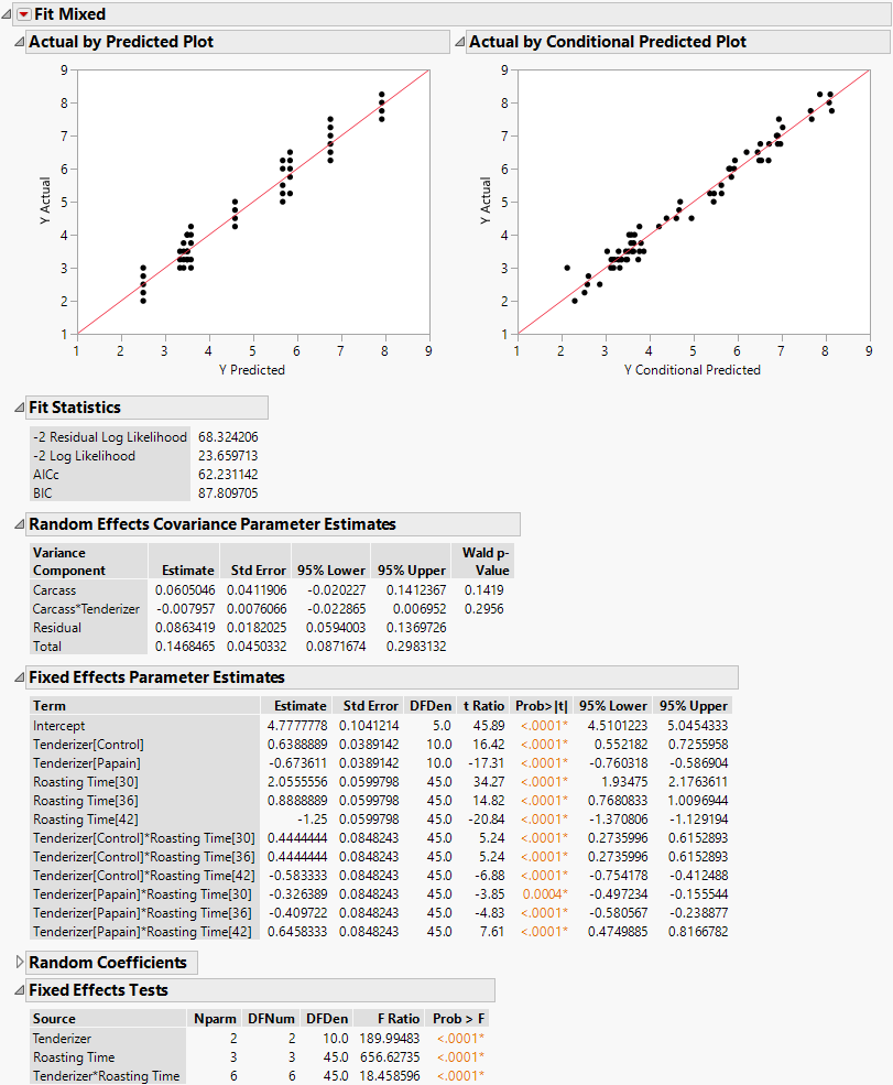

9. Click Run.
The Fit Mixed report is shown in Figure 8.29.
The Actual by Predicted Plot and the Actual by Conditional Predicted Plot show no issues with model fit, so you can proceed to interpret the results. The Fixed Effects Tests report indicates that there is a significant interaction between tenderizer and roasting time.
Figure 8.29 Fit Mixed Report

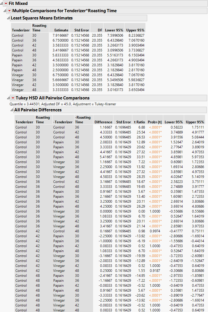

3. Click the Fit Mixed red triangle and select Multiple Comparisons.
4. Select Tenderizer*Roasting Time.
5. Select All Pairwise Comparisons - Tukey HSD and then click OK.
Figure 8.31 shows a partial list of pairwise comparisons. Most of the differences between papain and vinegar that you observed in the profiler are statistically significant. Therefore, it appears that papain is the better tenderizer.
Figure 8.31 Multiple Comparisons, Partial View
