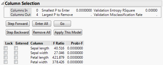

If you select the Stepwise Variable Selection option in the launch window, the Discriminant Analysis report opens, showing the Column Selection panel. You can perform stepwise analysis using the buttons to select variables or selecting them manually with the Lock and Entered check boxes. Based on your selection F ratios and p-values are updated. For more information about how these are updated, see Updating the F Ratio and Prob>F.
If you specify any type of validation set, a Go button appears. When you click Go, JMP uses the validation set statistics to determine how many steps to take.
Figure 5.4 Column Selection Panel for Iris.jmp with a Validation Set

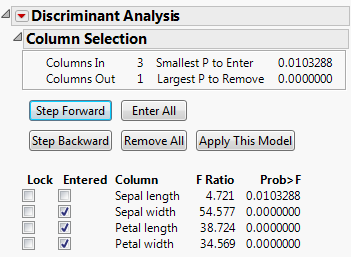

7. Click Step Forward three times.
Three covariates are entered into the model. The Smallest P to Enter appears in the top panel. It is 0.0103288, indicating that the remaining covariate, Sepal length, might also be valuable in a discriminant analysis model for Species.
Figure 5.5 Stepped Model for Iris.jmp

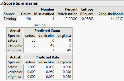

8. Click Apply This Model.
The Column Selection outline is closed. The window is updated to show reports for a fit based on the entered covariates and your selected discriminant method.
Note that the covariates that you selected for your model are listed at the top of the Score Summaries report.
Figure 5.6 Score Summaries Report Showing Selected Covariates
