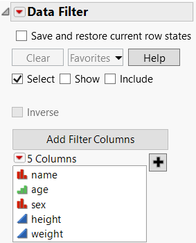

Figure 9.7 Initial Data Filter Window
2. Select the columns that you want to use as filters, and then click Add Image shown here.

• To restore your current row states when the Data Filter window is closed, select the Save and restore current row states option.
• If you have a long list of columns, you can sort, show, hide, or search for columns in the list. Use the options in the Add Filter Columns red triangle menu.
