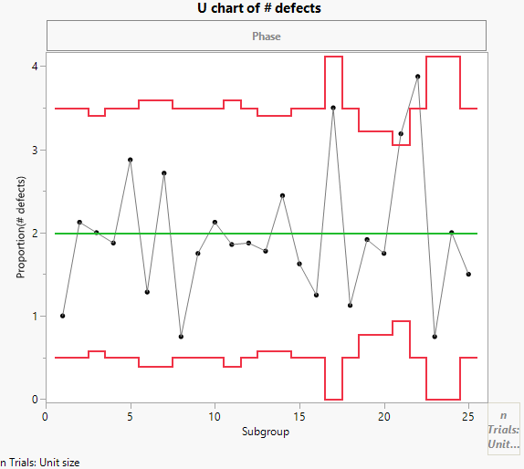

The Braces.jmp data in the Quality Control sample data folder records the defect count in boxes of automobile support braces. A box of braces is one inspection unit. The number of boxes inspected (per day) is the subgroup sample size, which can vary. The U chart in Figure 3.27 is monitoring the number of brace defects per subgroup sample size. The upper and lower bounds vary according to the number of units inspected.

Figure 3.27 U chart of # Defects
Because the sample sizes are not equal across subgroups, the limits are uneven. Two of the last five samples are not within the control limits.
