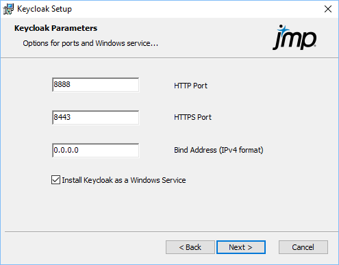

Figure 1.19 Configure Ports and Services
7.
Specify these Keycloak details:
HTTP port: Enter the HTTP network port. The default port is 8888. This port needs to be open to the Keycloak server.
HTTPS Port: Enter the HTTPS network port. The default port is 8443. This port needs to be open to the Keycloak server.
Bind Address (IPv4 format): Enter the IP address that the Keycloak instance listens on (using the specified port numbers) for requests. The default address is 0.0.0.0, which means that Keycloak accepts connections on all IP addresses assigned to the machine where Keycloak is installed.
Install Keycloak as a Windows Service: Select this option to install Keycloak as a Windows service. This means that Keycloak is automatically started, and if the machine reboots it automatically restarts, so that Keycloak is always running. If you do not select this option, you will need to start Keycloak manually the first time and anytime the machine is rebooted. This option is selected by default, and it is recommended to keep it selected.
8.
Click Next.

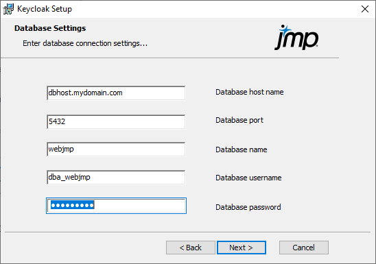

Figure 1.21 Configure Database Parameters
Keycloak stores information about users and clients in a database.
11.
Specify the database information:
Note: The following information should match what you entered when you installed the JMP Live database. See Install or Upgrade the JMP Live Database.
Database host name: Specify the alias or DNS name of the machine with the JMP Live database.
Database port: Specify the port that the database listens on.
Database name: Specify the name of the JMP Live database.
Database username: Specify the user name of the database administrator.
Database password: Specify the password of the database administrator.
12.
Click Next.

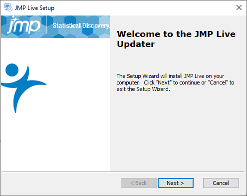

Install or Update JMP Live
How to proceed
If you have an existing 16.0 version of JMP Live, update JMP Live. See Update JMP Live.
If this is your first time installing JMP Live, follow the normal installation procedures at Install JMP Live.
Update JMP Live
Prerequisite if you are using Windows Remote Desktop
If you are installing JMP Live using Windows Remote Desktop, make sure that the option do not use temporary folders per session is enabled. To check if this option is enabled, perform these steps:
On your Windows machine, open a command prompt.
Enter cd %temp%.
If you are taken to C:\Users\<user ID>\AppData\Local\Temp\2>, then do not use temporary folders per session is disabled. You need to enable this option before proceeding with the JMP Live installation.
If you are taken to C:\Users\<user ID>\AppData\Local\Temp>, then do not use temporary folders per session is enabled and you can proceed with the JMP Live installation.
Update JMP Live
Double-click JMPLive.exe.
By default, this file is located where the Software Depot is downloaded, under this folder structure: \JMP\JMP_Live_Server\16_1\Windows\.
Figure 1.26 Select Your Setup Language
Select your setup language, and then click Next.
Figure 1.27 Select Prerequisites to Install
Node.js is selected by default and must be installed.
Click Next.
Figure 1.28 JMP Live Setup Wizard
Click Next.
Figure 1.29 Start JMP Live Installation
Click Install to start the JMP Live installation, and Finish once the installer is done.
