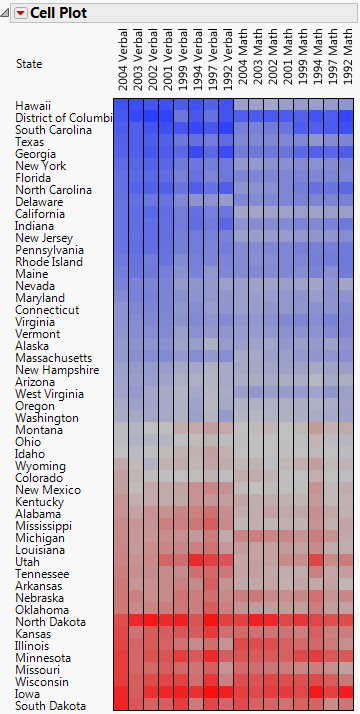

The report window appears.
7. Right-click the plot under 2004 Verbal (the top left cell) and select Sort Ascending.
This sorts the cell plot by the verbal scores for 2004.
Figure 8.6 Cell Plot for SAT Scores
You notice the following:
• Hawaii has the lowest verbal scores for 2004, and South Dakota has the highest verbal scores for 2004.
• There is a contrast between Hawaii’s math and verbal scores. Hawaii has average math scores (represented by gray color values) but low verbal scores (represented by blue color values). Hawaii appears to be an outlier, since it has a strikingly different pattern for its math scores and its verbal scores.
• There is very little contrast between North Dakota’s math and verbal scores. North Dakota’s math and verbal scores are generally high (represented by red color values).
