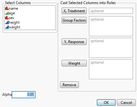

Column Dialog(), a variant of the deprecated Dialog() function, lets you prompt for column selections from the current data table or contextual data table. The OK, Cancel, and Remove buttons and the list of columns to choose from the data table are added automatically.
dlg = Column Dialog(
	Col ID = Col List( "X, Treatment", Max Col( 1 ) ),
	Group = Col List( "Group Factors" ),
	Split = Col List( "Y, Response" ),
	w = Col List( "Weight" ),
	H List( "Alpha", alpha = Edit Number( .05 ) )
Figure 11.36 Column Dialog
Column Dialog
The following example returns a list similar to this one, depending on the user’s choices:
{Col ID = {}, Group = {}, Split = {}, w = {}, alpha = 0.05, Button( -1 )}
For each destination list, a Col List clause must be a direct argument of Column Dialog() (not nested inside some other argument). An optional MaxCol(n) argument restricts the number of data columns that can be chosen to n. Lists are always returned, although they can sometimes be empty lists. You can include as many as twelve Col List clauses.

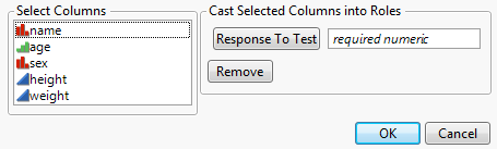

The following example generates a column dialog box that only allows the selection of exactly one numeric column:
rt_dlg = Column Dialog(
	cv = Col List( "Response To Test", MaxCol( 1 ), MinCol( 1 ), DataType( "Numeric" ) )
Figure 11.37 Restricting Selection of Columns
The Data Type choices are Numeric, Character, and Any.
