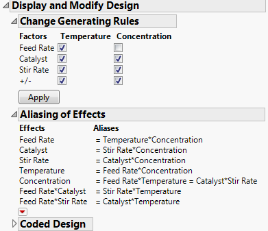

Figure 9.16 shows the default-generating rules for a 25-2 fractional factorial design (five factors and eight runs).
Figure 9.16 Generating Rules for the Standard 25-2 Design
In each column of the Change Generating Rules panel, the factor listed at the top and the factors in the column whose boxes are selected form a word in the defining relation. For example, the first column indicates that Temperature = Feed Rate*Catalyst*Stir Rate is a word in the defining relation.

The principal fraction of a full factorial design is the fractional factorial design obtained by setting all the defining relations equal to the identity. By default, the factorial design that JMP provides is the principal fraction. Notice that the +/- box is selected by default for all generating rules, so that each word in the defining relation equals the identity.
Generating rules determine the coding and aliasing of effects for the design. In some cases, you might want to use a fraction that results in a coding or an aliasing structure that differs from that of the standard fraction.
• To change the generating rules, select the appropriate boxes.
• To see the effect of your selections on the Aliasing of Effects results and on the Coded Design, click Apply.
For an example, see Change the Generating Rules to Obtain a Different Fraction.

Figure 9.16 shows two columns of check boxes:
• The first column represents the word Temperature = Feed Rate*Catalyst*Stir Rate.
• The second column represents the word Concentration = Catalyst*Stir Rate.
Define I to represent a column consisting of the values +1. Because all factor levels are -1 or +1, the word in the first column is equivalent to Temperature*Feed Rate*Catalyst*Stir Rate = I. The word in the second column is equivalent to Concentration*Catalyst*Stir Rate = I. Together, these give the defining relations for the 25-2 design:
I = Temperature*Feed Rate*Catalyst*Stir Rate = Concentration*Catalyst*Stir Rate

The aliasing structure in the Aliasing of Effects outline is determined by the defining relations and the fact that factor levels are +1 and -1. Recall that the first generating rule is Temperature = Feed Rate*Catalyst*Stir Rate and the second is Concentration = Catalyst*Stir Rate.
To obtain the first relation in the Aliasing of Effects outline, notice that applying these two generating rules gives the expression:
Temperature = Feed Rate*Catalyst*Stir Rate = Feed Rate*Concentration
– The second equality follows from replacing Catalyst*Stir Rate by Concentration using the second generating rule.
Now, post-multiply the first and third expressions by Concentration to obtain the following expression:
Temperature*Concentration = Feed Rate*Concentration*Concentration
Because the column for Concentration in the design matrix contains values of -1 and +1, the term Concentration*Concentration represents a column of +1 values. The expression becomes the first alias relation shown in the Aliasing of Effects outline:
Temperature*Concentration = Feed Rate*I = Feed Rate
The other alias relations can be obtained using similar calculations.
