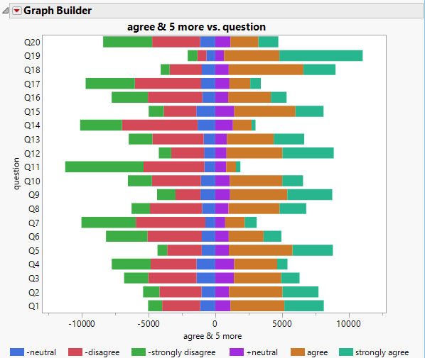

3. Select question and drag it to the Y zone.
4. Select agree, strongly agree, -strongly disagree, -disagree, -neutral, and +neutral and drag them to the X zone.
5. Click the Bar element Image shown here.
6. In the Bar properties panel, do the following:
– Change the Bar Style to Stacked.
– Open Variables, and then highlight a variable and use the arrow icons to move them into this order, from top to bottom: -neutral, -disagree, -strongly disagree, +neutral, agree, strongly agree.
Figure 4.14 Completed Bar Properties Panel
7. Click the Graph Builder red triangle and select Legend Position > Bottom.
8. Click Done.
Figure 4.15 Graph Prior to Legend Customizations
