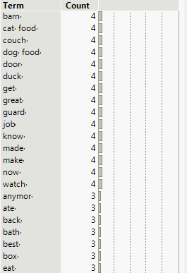

8. Scroll down in the Term List and find the cat and dog food entries.
You can see that there are four occurrences of each phrase.
Figure 12.3 Term List after Modifications and Scrolling
In the Phrase List, cat food and dog food are gray, since they are now locally being treated as terms in this Text Explorer report.

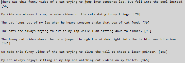

A window appears that contains the text of the seven documents represented by the selected points. These survey responses are similar in that they all refer to some combination of “funny”, “cat”, and “video”. These documents have larger positive values for the first singular vector than the rest of the documents. These larger values indicate that they are different from the rest of the documents in that dimension.
