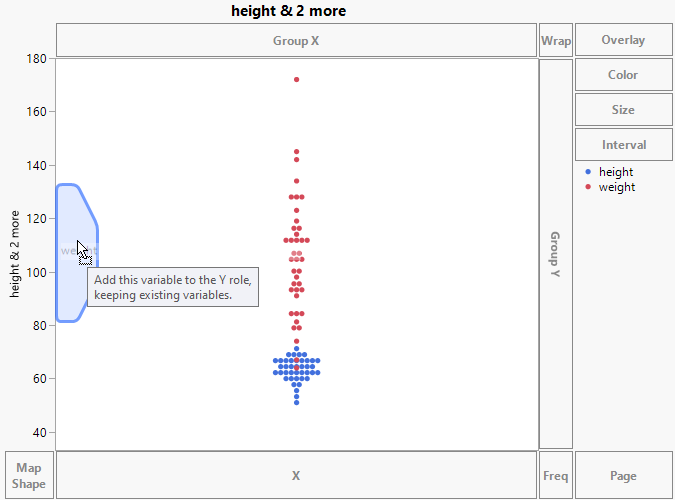

Merging variables places both variables on the same axis and creates a single graph for both variables. Elements in the plot are colored by the variables, and a legend appears to the right of the plot. When points are plotted, they are randomly jittered for each value or category defined by the combination of the axes.
• If you are starting with an empty zone, highlight multiple variables from the list and drag them into the zone at the same time.
• If you already have variables in the zone and want to add more, drag the new variables to the inner side of the zone, in the graph area, until a symmetric polygonal shape appears.
Figure 3.11 New Variable Merged with Existing Variable
