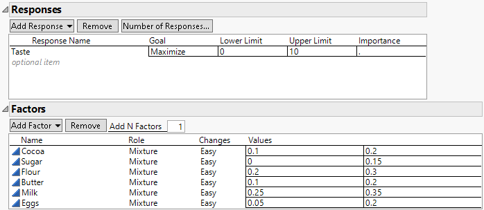

6. Select Help > Sample Data Library and open Design Experiment/Cake Factors.jmp.
7. Click the Custom Design red triangle and select Load Factors.
Figure 5.58 Completed Responses and Factors Outlines
Note that the factors are all mixture factors. The Values that define the range of settings for the experiment vary from factor to factor.

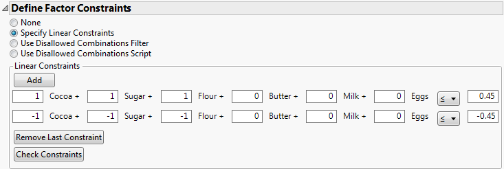

8. In the Define Factor Constraints outline, select Specify Linear Constraints.
9. In the Linear Constraints panel, click Add twice.
10. Enter the constraints shown in Figure 5.59.
Figure 5.59 Define Factor Constraints
Note that the second constraint is equivalent to specifying that the sum of Cocoa, Sugar, and Flour is greater than or equal to 0.45. The two constraints together imply that Cocoa, Sugar, and Flour comprise exactly 45% of the mixture, ensuring that the wet factors constitute the remaining 55%.

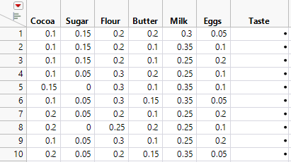

Figure 5.60 Mixture of Mixtures Design
The settings for the dry ingredients, Cocoa, Sugar, and Flour, sum to 45% of the mixture and the settings for the wet ingredients, Butter, Milk, and Eggs, sum to 55% of the mixture. The settings also conform to the upper and lower limits given in the Factors outline.

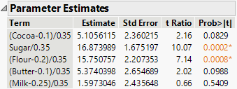

The Parameter Estimates report indicates that Sugar and Flour are significant at the 0.05 level.
Figure 5.61 Parameter Estimates Report
