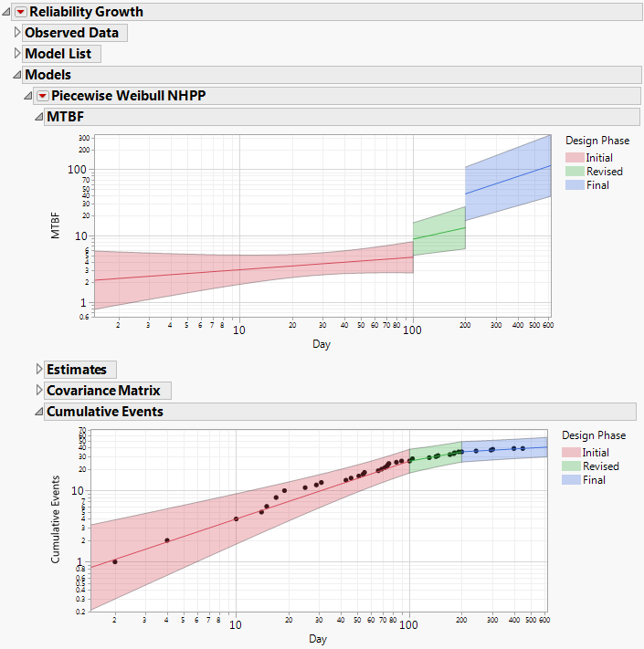

Figure 10.1 Example of Plots for a Three-Phase Reliability Growth Model
