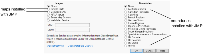

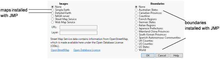

The Background Map window shows two columns of choices: Images and Boundaries. On the left of the window that you can select from two built-in map images, or you can connect to a Web Map Service to retrieve a background image. On the right side of the window, you can select political boundaries for a number of regions.
Figure 12.12 Example of Background Map Options
