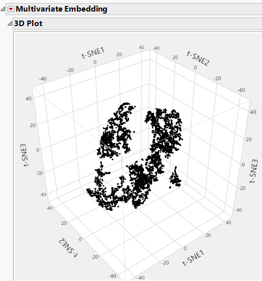

Figure 11.4 Example of a 3D t-SNE PlotĀ
Compared to the two-dimensional reduction, the three-dimensional reduction improves the clustering of the data. There are more distinct clusters visible in the 3D t-SNE plot as compared to the two-dimensional scatterplot in Figure 11.2.
Tip: You can rotate the grid to view the clusters more clearly.
