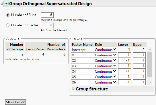

Build a Group Orthogonal Supersaturated Design by selecting DOE > Special Purpose > Group Orthogonal Supersaturated > Group Orthogonal Supersaturated Design.
Figure 27.2 Group Orthogonal Supersaturated Design Window
The GOSSD design updates as you work through the design steps.
• Specify Factors, Structure, and Make Design
• Verify Design and Make Table
