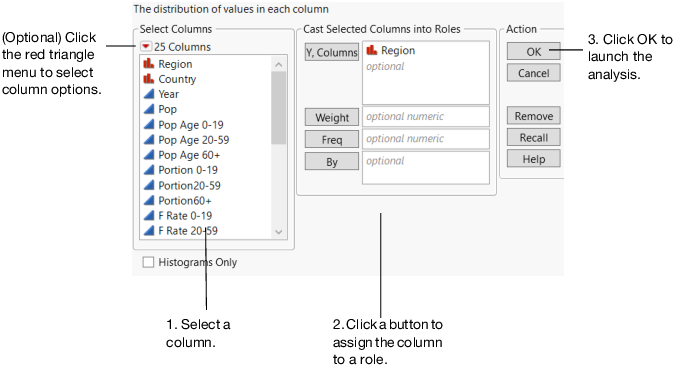

The launch window is your point of entry into a platform, where you specify the columns to analyze. Figure 2.11 shows the Distribution launch window.
Figure 2.11 Launch Window Features
All launch windows have in common provide the following options:
Select Columns
Lists all of the variables in your current data table. Note the following:
– Right-click the modeling type icon next to a column name to change the modeling type.
– Right-click the column name to create a transform column. See Transform Columns in a JMP Platform.
– Filter and sort the columns using the options in the red triangle menu. See Column Filter Menu.
Cast Selected Columns into Roles
Moves selected columns into roles (such as Y, X, and so on.) You cast a column into the role of a variable (like an actor is cast into a role). See Cast Selected Columns into Roles Buttons.

Action
The following options are available:
OK
Performs the analysis.
Cancel
Stops the analysis and quits the launch window.
Remove
Deletes any selected variables from a role.
Recall
Populates the launch window with the last analysis that you performed.
Help
Takes you to the Help for the launch window.

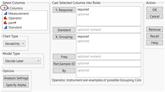

The following buttons frequently appear throughout launch windows. Buttons that are specific to certain platforms are described in the chapter for the specific platform.
Y
Identifies a column as a response or dependent variable whose distribution is to be studied.
X
Identifies a column as an independent, classification, or explanatory variable that predicts the distribution of the Y variable.
Weight
Identifies the data table column whose variables assign weight (such as importance or influence) to the data.
Freq
Identifies the data table column whose values assign a frequency to each row. This option is useful when a frequency is assigned to each row in summarized data. If the value is 0 or a positive integer, then the value represents the frequencies or counts of observations for each row when there are multiple units recorded.
Image shown hereValidation
Identifies the data table column whose values assign rows to training, validation, and test sets for cross validation in fitting models.
Notes:
– For some platforms, KFold validation is available if you specify more than three levels in the Validation column.
– If you click the Validation button with no columns selected in the Select Columns list, you have the option to create a Validation column. For more information about the Make Validation Column utility, see Make Validation Column in Predictive and Specialized Modeling.
By
Identifies a column that creates a report consisting of separate analyses for each level of the variable.
