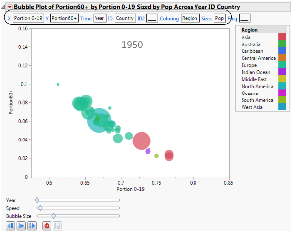

In the Bubble Plot red triangle menu, use the Show Roles option to change existing variables without having to relaunch the platform and restart your analysis.
Follow the instructions in Example of a Dynamic Bubble Plot to produce the report window shown in Figure 5.6. (The colors are the JMP default colors.)
Figure 5.6 Example of Bubble Plot with Show Roles Selected
