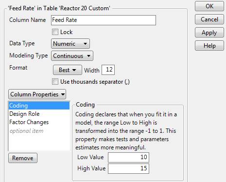

The Coding column property applies only to columns with a numeric data type. It applies a linear transformation to the data in the column. In the Coding column property window, you specify a Low Value and a High Value. The values correspond to the factor levels you set when generating a designed experiment. JMP transforms the low and high values to –1 and +1 whenever the column is entered as a model effect in the Fit Model platform.

When any DOE platform other than Accelerated Life Test Design creates a design, JMP defines a Coding column property for each non-mixture factor with a numeric data type. Figure A.12 shows the Coding column property panel for the column Feed Rate in the Reactor 20 Custom.jmp sample data table, found in the Design Experiment folder.
Figure A.12 Coding Property Panel for Feed Rate
