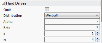

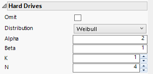

Figure 12.16 Example of a Weibull Configuration for a K out of N Shape
