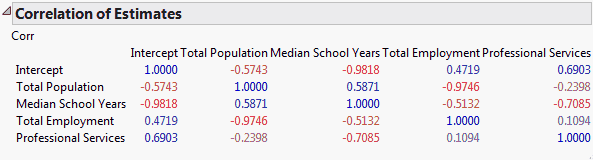

7. Click the red triangle next to Response Median House Value and select Estimates > Correlation of Estimates.
Figure 3.35 Correlation of Estimates Report
The report shows high negative correlations between the parameter estimates for the Intercept and Median School Years (–0.9818). High negative correlations also exist between Total Population and Total Employment (–0.9746).
