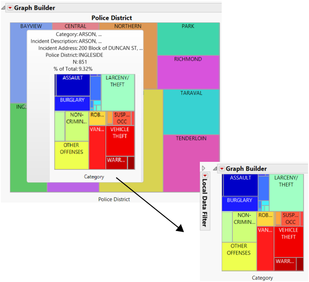

A drill-down graph is created when you click on the thumbnail in a hover label. Clicking on the hover graph opens it in a new window, enabling you to see the graph in more detail and also make modifications such as changing the data filter. For example, click a cell on a treemap to see details about the data in a new window (Figure 12.48). Press Ctrl and click to replace the contents of the last launched window instead of opening a new window.

Figure 12.48 shows drilling-down on a cell in a treemap.
Figure 12.48 Example of a Drill-Down Graph on a Hover Label
The following script creates the simplified versions of the treemap presets shown in Figure 12.48.

/* Graph Builder treemap based on the first level of our hierarchy, "Police District" */
gb = dt << Graph Builder(

/* configure the graphlet -- a hover label extension that adds a visualization
	thumbnail to the hover label. Clicking on the thumbnail launches the
	associated visualization in its own window (or replaces the graph in the
	current window on a Ctrl-click). */
frame << Set Graphlet(
