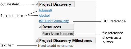

Figure 10.29 shows some of the items that you can add to a journal.
Figure 10.29 Example of a Journal
