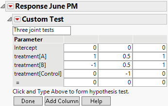

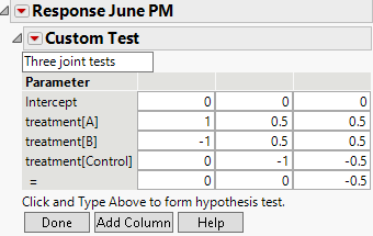

Figure 3.26 shows an example of the specification window with three contrasts, using the Cholesterol.jmp sample data table. Note that the constant is set to zero for all three tests. The report for these tests is shown in Figure 3.27.

7. In the Custom Test specification report, click Add Column twice to create two additional columns.
8. Fill in the editable area with a test name and enter values in the three columns as shown in Figure 3.26.
To see how to obtain these values, particularly those in the third column, see Interpretation of Parameters.
Figure 3.26 Custom Test Specification Report for Three Contrasts

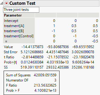

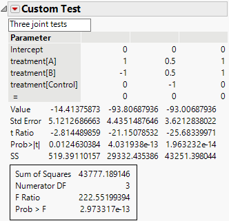

9. Click Done.
The results shown in Figure 3.27 indicate that all three hypotheses are individually, as well as jointly, significant.
Figure 3.27 Custom Test Report Showing Tests for Three Contrasts
