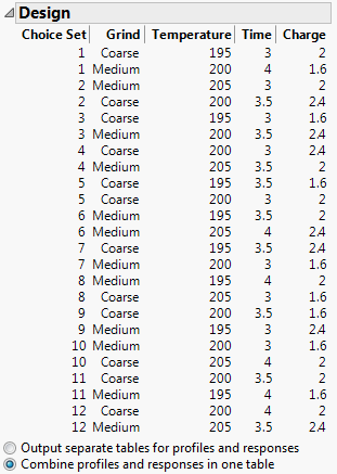

The Design section shows the runs for a choice design that is optimal, given your selections. Review the design to ensure that it meets your needs.
Figure 19.19 Design
Design
Notes:
• Figure 19.19 is taken from the coffee example. See Example of a Choice Design.
• The algorithm for finding an optimal design is based on a random starting design. Because of this, the design you obtain is not unique. The design algorithm will generate different designs when you click the Back and Make Design buttons repeatedly.
