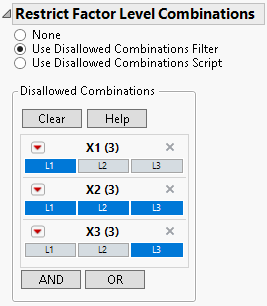

5. Select Use Disallowed Combinations Filter.
6. From the Add Filter Factors list, select all three factors and click the Add button.
7. Press Ctrl and select the following levels:
– For X1, select L1.
– For X2, select L1, L2, and L3.
– For X3, select L3.
Figure 21.19 Completed Restrict Factor Level Combinations Panel

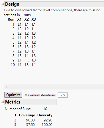

10. Click Make Design.
Figure 21.20 Design and Metrics
Design and Metrics
A note beneath the Design section indicates that one run has a missing setting due to the constraints. That run is run 9. To ensure that the covering array has strength 2, the combination of X1 set to L1 and X3 set to L3 is required. But for these settings, the constraints prohibit all settings for X2.
