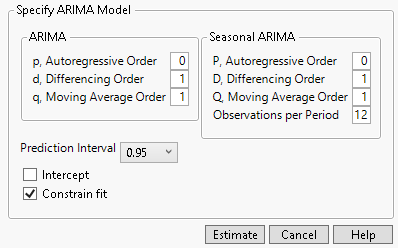

8. In the ARIMA section of the Seasonal ARIMA Specification window, set the following parameters.
– Set p, Autoregressive Order to 0.
– Set d, Differencing Order to 1
– Set q, Moving Average Order to 1
9. In the Seasonal ARIMA section of the Seasonal ARIMA Specification window, set the following parameters.
– Set P, Autoregressive Order to 0
– Set D, Differencing Order to 1
– Set Q, Moving Average Order to 1
10. Deselect Intercept to run a model without an intercept.
Your window should now match the window shown in Figure 18.22.
Figure 18.22 Seasonal ARIMA Specifications

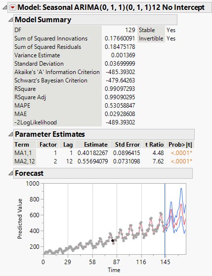

11. Click Estimate.
Figure 18.23 Seasonal ARIMA Model for Box-Cox Transformed Passengers Data
The parameter estimates are equivalent to those obtained from running the same model on the Log Passengers column. However, the forecasts and prediction intervals in Figure 18.23 are on the original scale.
