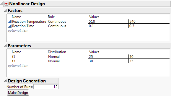

In this example, the values 510 and 540 for Reaction Temperature and 0.1 and 0.3 for Reaction Time were specified using the Coding column property. Alternatively, you can specify a reasonable range of values directly in the Factors section.
6. Change the values of the parameter t1 to 25 and 50, and t3 to 30 and 35.
These new values represent a reasonable range of parameter values for the experimental situation. The default values were constructed based on the initial parameter values that were specified in the definition of the prediction formula. For information about constructing formulas, see Create Formulas in JMP in Using JMP.
Notice that the prior distribution, shown under Distribution, for each of t1 and t3 is set to Normal by default.
7. Change the number of runs to 12 in the Design Generation panel.
Figure 24.2 Completed Sections for Reaction Kinetics Experiment
8. Click Make Design.

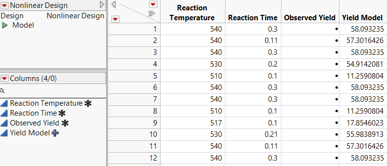

9. Click Make Table.
Figure 24.3 Design Table
Design Table
Your design should be similar to the one shown in Figure 24.3. The runs might be in a different order, and the values for Reaction Temperature and Reaction Time, and consequently those computed for Yield Model, can be slightly different. Notice that values appear in the Yield Model column because the column contains the formula for the model. Also notice that the table contains a Model script that you can use to fit a nonlinear model to your observations.
Now that you have created your design table, run your experiment, and record the responses in the Observed Yield column. The data table Reaction Kinetics.jmp, found in the Design Experiment folder contains observed results for the design.

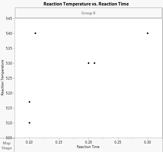

Before analyzing your results, construct a plot to see the design settings.
1. Select Help > Sample Data Folder and open Design Experiment/Reaction Kinetics.jmp.
1. Select Graph > Graph Builder.
2. Drag and drop Reaction Temperature into the Y zone.
3. Drag and drop Reaction Time into the X zone.
4. Click the second icon above the graph to deselect the Smoother.
Figure 24.4 Design Settings
Design Settings
Notice that the points are located in three areas. There are no points at low temperature and high time (the lower right corner of the graph). Unlike orthogonal designs, nonlinear designs do not necessarily place design points at the corners of the design region. In this example, design points at low temperature and high time would be inefficient.

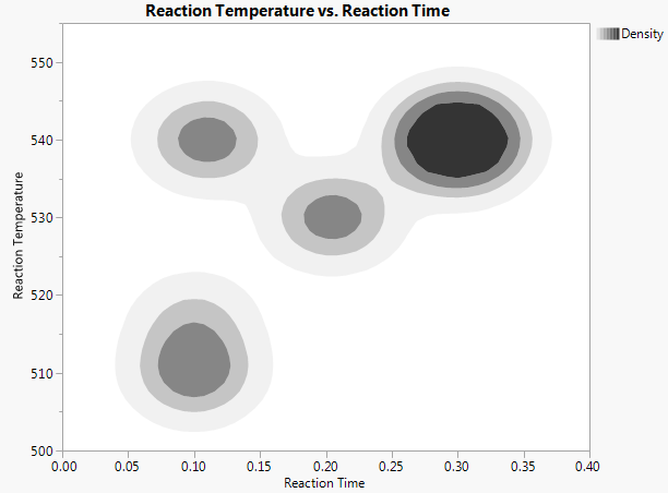

To see the density of design points in the remaining three corners, use the Contour tool.
5. Click Image shown here to turn on the Contour tool.
6. Click Done.
Figure 24.5 Design Settings with Density Contours
Notice that there are comparatively few points at low time and high temperature. From the design table, you can see that there are only two such points. Because of the model and the parameter specifications, the optimal design places more design points at high time and high temperature.

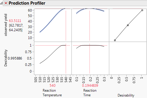

6. Click the Nonlinear Fit red triangle and select Profilers > Profiler.
7. To maximize the yield, click the Prediction Profiler red triangle and select Optimization and Desirability > Maximize Desirability.
Figure 24.6 Time and Temperature Settings for Maximum Yield
The estimated maximum yield is approximately 63.5% at a reaction temperature of 540 degrees Kelvin and a reaction time of 0.1945 minutes.
