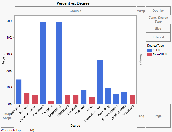

7. In the Graph Builder column list, select Degree Type and drag it to the Color zone.
Figure 4.3 Bar Chart Colored by Degree Type

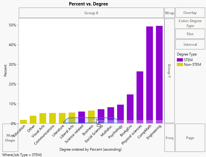

9. In the Graph Builder column list, select Percent and drag it above the X axis. See Figure 4.4.
Figure 4.4 Ordering Degree by Percent
This orders the degree by percent in ascending order. However, you want it to be in descending order.
10. Right-click the X axis and select Order By > Percent, descending.

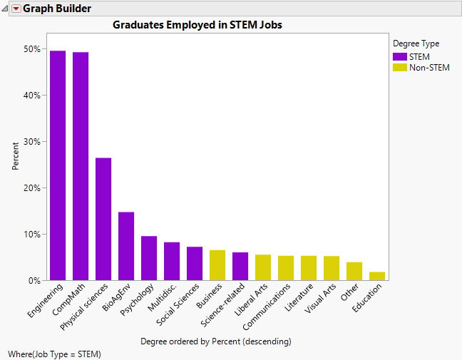

11. Click the graph title and type Graduates Employed in STEM Jobs and press Enter.
12. Click Done.
Figure 4.5 Completed Bar Chart
Completed Bar Chart
This graph displays the percent of graduates employed in STEM jobs by their degree type. Nearly 50% of Engineering and CompMath graduates are employed in STEM jobs, as compared to less than 2% of Education graduates.
