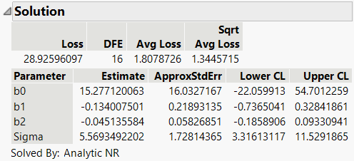

7. Click Confidence Limits.
The parameter estimates with confidence limits are shown in Figure 15.23.
Figure 15.23 Solution Report
Solution Report
