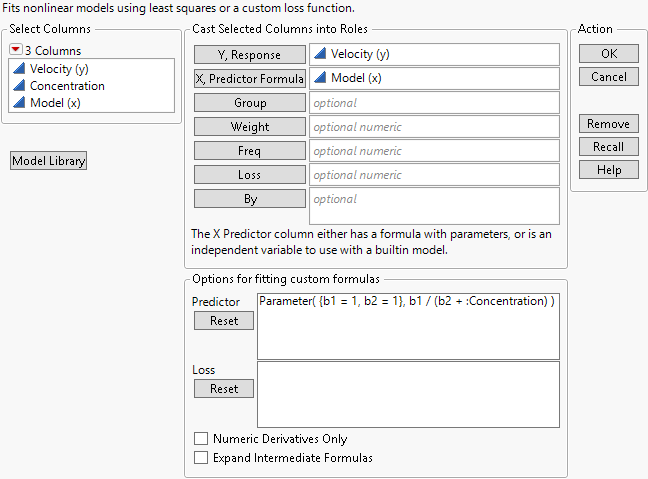

5. Select Analyze > Specialized Modeling > Nonlinear.
6. Select Velocity (y) and click Y, Response.
7. Select Model (x) and click X, Predictor Formula.
Notice that the formula given by Model (x) appears in the Options for fitting custom formulas panel.

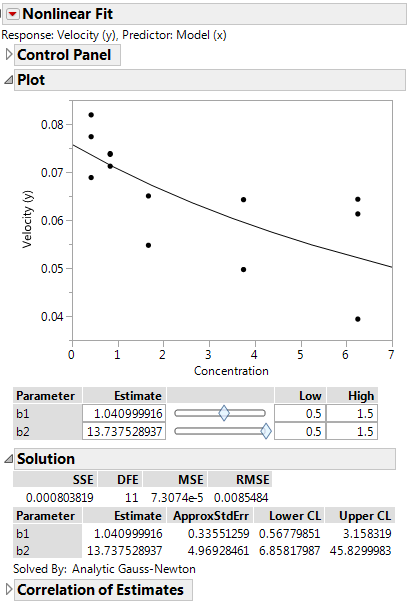

9. In the Control Panel, click Go.
The iterative search for a solution proceeds until one of the Stop Limit values is reached. Then, the Solution and Correlation of Estimates reports appear. Also, an option appears in the Control Panel enabling you to add confidence limits to the Solution report.

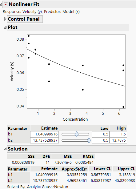

10. In the Control Panel, click Confidence Limits.
Confidence intervals for the parameters b1 and b2 appear in the Solution report.
Figure 24.8 Nonlinear Fit Results
The Lower CL and Upper CL values for b1 and b2 define ranges of values for these parameters. Next, use these intervals to define a range for the prior values in your augmented nonlinear design.

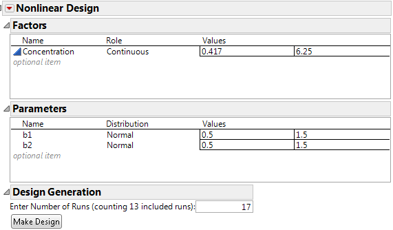

In the Chemical Kinetics.jmp data, the values for Concentration range from 0.417 to 6.25. Therefore, these values initially appear as the low and high values in the Factors section. You want to change these values to encompass a broader interval.
5. Click 0.417 and type 0.1. Click 6.25 and type 7.
6. Leave the prior Distribution for each parameter set to Normal.

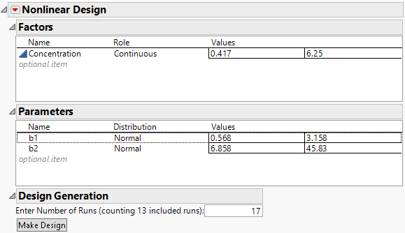

The range of Values for the parameters reflects the uncertainty of your knowledge about them. You could specify a range that you think covers 95% of possible parameter values. The confidence limits from the Nonlinear Fit report shown in Figure 24.8 provide such a range. Replace the Values for the parameters in the Parameters section with the confidence limits, rounding to three decimal places.
7. In the DOE Nonlinear Design window, enter these values into the Parameters for b1 and b2:
– b1: 0.568 and 3.158
– bb2: 6.858 and 45.830
