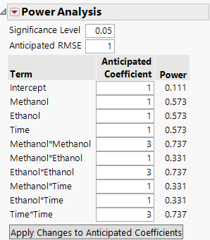

6. Open the Power Analysis section.
Note that the Anticipated RMSE is set to 1 by default. Although you have an estimate of the RMSE from past studies, you need not enter it. This is because the magnitude of the effect of interest is three times the error variation.
7. Under Anticipated Coefficient, type 3 next to Methanol*Methanol, Ethanol*Ethanol, and Time*Time.
8. Click Apply Changes to Anticipated Coefficients.
Figure 16.9 Power Analysis after Applying Changes to Coefficients
The power of detecting a quadratic effect whose magnitude is three times the error variation is 0.737. This assumes a final model that is a response surface in three factors. It also assumes a 0.05 significance level for the test.
