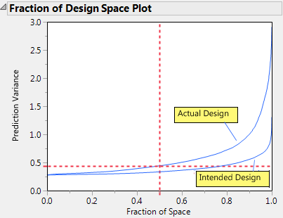

Figure 16.1 Comparison of Two Fraction of Design Space Plots
