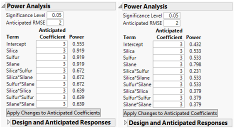

Power Analysis
In each window, do the following:
1. Open the Power Analysis section.
The section shows default values of 1 for all Anticipated Coefficients. These values correspond to detecting a change in the anticipated response of 2 units across the levels of main effect terms, assuming that the interaction and quadratic terms are not active.
The power calculations assume an error term (Anticipated RMSE) of 1. From previous studies, you believe that the RMSE is approximately 2.
2. Type 2 next to Anticipated RMSE.
When you click outside the text box, the power values are updated.
You are interested in detecting differences in the anticipated response that are on the order of 6 units across the levels of main effects, assuming that interaction and quadratic terms are not active. To set these uniformly, use a red triangle option.
3. Click the Power Analysis red triangle and select Set Delta for Power
4. Type 6 as your value for delta.
5. Click OK.
Figure 16.2 shows both sections, with the Design and Anticipated Responses section closed.
Figure 16.2 Power Analysis, Intended Design (Left) and Actual Design (Right)
The power values for the actual design are uniformly smaller than for the intended design. For Silica and Sulfur, the power of the tests in the intended design is almost twice the power in the actual design. For the Silica*Sulfur interaction, the power of the test in the actual design is 0.231, compared to 0.672 in the intended design. The actual design results in substantial loss of power in comparison with the intended design.

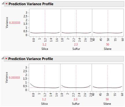

Prediction Variance Profile
1. In each window, open the Prediction Variance Profile section.
2. In the window for the actual design, right-click on the vertical axis and from the menu select Edit > Copy Axis Settings.
This action creates a script containing the axis settings. Next, apply these axis settings to the Prediction Variance Profile plot for the intended design.
3. In the Evaluate Design window for the intended design, locate the Prediction Variance Profile section. Right-click on the vertical axis and from the menu select Edit > Paste Axis Settings.
The plots are shown in Figure 16.5, with the plot for the intended design at the top and for the actual design at the bottom.
Figure 16.3 Prediction Variance Profile, Intended Design (Top) and Actual Design (Bottom)
The Prediction Variance Profile plots are profiler views of the relative prediction variance. You can explore the relative prediction variance in various regions of design space.
Both plots show the same relative prediction variance in the center of the design space. However, the variance for points near the edges of the design space appears greater than for the same points in the intended design. Explore this phenomenon by moving all three vertical lines to points near the edges of the factor settings.

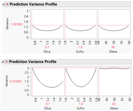

Figure 16.4 shows the maximum relative prediction variance for the intended and actual designs.
Figure 16.4 Prediction Variance Profile Maximized, Intended Design (Top) and Actual Design (Bottom)
For both designs, the profilers identify the same point as one of the design points where the maximum prediction variance occurs: Silica=0.7, Sulfur=1.8, and Silane=40. The maximum prediction variance is 1.396 for the intended design, and 3.021 for the actual design. Note that there are other points where the prediction variance is maximized. The larger maximum prediction variance for the actual design means that predictions in parts of the design space are less accurate than they would have been had the intended design been conducted.

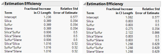

Estimation Efficiency
In each window, open the Estimation Efficiency section.
Figure 16.6 Estimation Efficiency, Intended Design (Left) and Actual Design (Right)
In the actual design (right), the relative standard errors for all parameters either exceed or equal the standard errors for the intended design (left). For all except three of the non-intercept parameters, the relative standard errors in the actual design exceed those in the intended design.
The Fractional Increase in CI Length compares the length of a parameter’s confidence interval as given by the current design to the length of such an interval given by an ideal design of the same run size. The length of the confidence interval, and consequently the Fractional Increase in CI Length, is affected by the number of runs. See Fractional Increase in CI Length. Despite the reduction in run size, for the actual design, the terms Silane, Silica*Silane, and Sulfur*Silane have a smaller increase than for the intended design. This is because the two runs that were removed to define the actual design had Silane set to its center point. By removing these runs, the widths of the confidence intervals for these parameters more closely resemble those of an ideal orthogonal design, which has no center points.

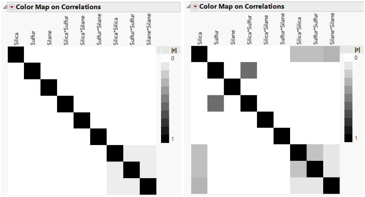

Color Map on Correlations
In each report, do the following:
1. Open the Color Map On Correlations section.
The two color maps show the effects in the Model section. Each plot shows the absolute correlations between effects colored using the JMP default white to black intensity scale. Ideally, you would like zero or very small correlations between effects.
Figure 16.7 Color Map on Correlations, Intended Design (Left) and Actual Design (Right)
The absolute values of the correlations range from 0 (white) to 1 (black). Hover over a cell to see the value of the absolute correlation. The color map for the actual design shows more absolute correlations that are large than does the color map for the intended design. For example, the correlation between Sulfur and Silica*Sulfur is < .0001 for the intended design, and 0.5774 for the actual design.

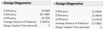

Design Diagnostics
In each report, open the Design Diagnostics section.
Figure 16.8 Design Diagnostics, Intended Design (Left) and Actual Design (Right)
The intended design (left) has higher efficiency values and a lower average prediction variance than the actual design (right). The results of the Design Evaluation analysis indicate that the two lost runs have had a negative impact on the design.
