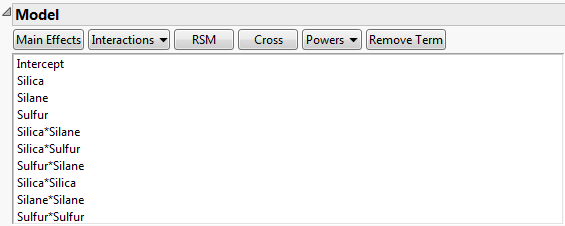

Figure 16.13 shows the Model section for the Bounce Data.jmp data table, found in the Design Experiment folder. The Model script in the data table contains response surface effects for the three factors Silica, Silane, and Sulfur. Consequently, the Model section contains the main effects, two-way interactions, and quadratic effects for these three factors.
Figure 16.13 Model for Bounce Data.jmp
