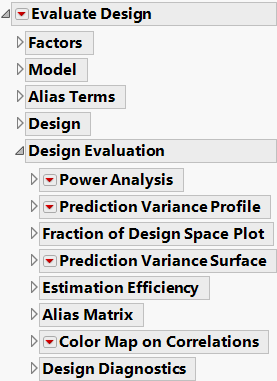

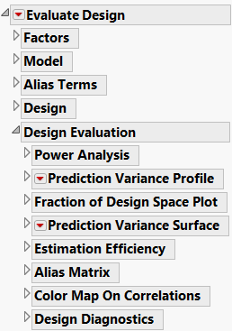

The Evaluate Design window consists of two parts: defining the model and design and evaluating the design. See Figure 16.11, where all section nodes are closed.
• The Factors, Model, Alias Terms, and Design sections define the model and design.
• The Design Evaluation section provides results that describe the properties of your design.
Figure 16.11 Evaluate Design Window Showing All Possible Sections
The Factors, Model, Alias Terms, and Design sections contain information that you enter about the factors, assumed model, potentially aliased effects of interest, and the actual design. JMP populates these sections using your selections in the launch window and the design table. However, you can modify the effects in the Model and Alias Terms sections. Once you have made your specifications, the Design Evaluation sections are updated. You can open these sections to see reports or control windows that provide information about your design.
