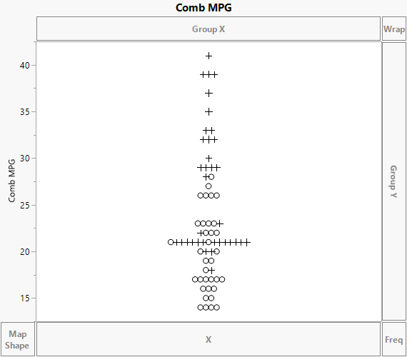

3. Select Comb MPG (combined miles per gallon) and drag it to the Y zone.
Figure 3.4 Initial Graph of Combined MPG

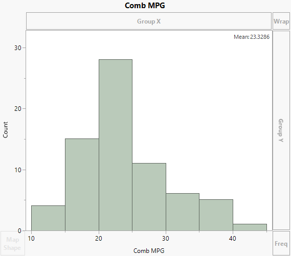

Because markers are assigned to rows in the data table, points are represented by those markers. The value of Comb MPG for each row is plotted at its value on the vertical axis. To avoid over-plotting points that correspond to observations with the same Comb MPG values, JMP automatically jitters the points.

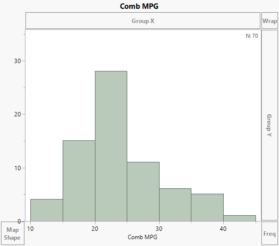

You can get a cleaner picture of the distribution by plotting a histogram.
4. Click the Histogram icon Image shown here.
You want the histogram to be vertical, so you need to move Comb MPG to the X zone.
5. Hover over Comb MPG in the Y axis. The cursor turns into a hand. Select and drag Comb MPG into the X zone.
6. Click the Caption Box icon Image shown here to show the mean Comb MPG on the graph.
Figure 3.5 Histogram of Combined MPG
The histogram shows that Comb MPG can range widely, from about 10 to 45. However, a lot of vehicles get mileage between 15 and 30. The mean MPG is 23.3286.

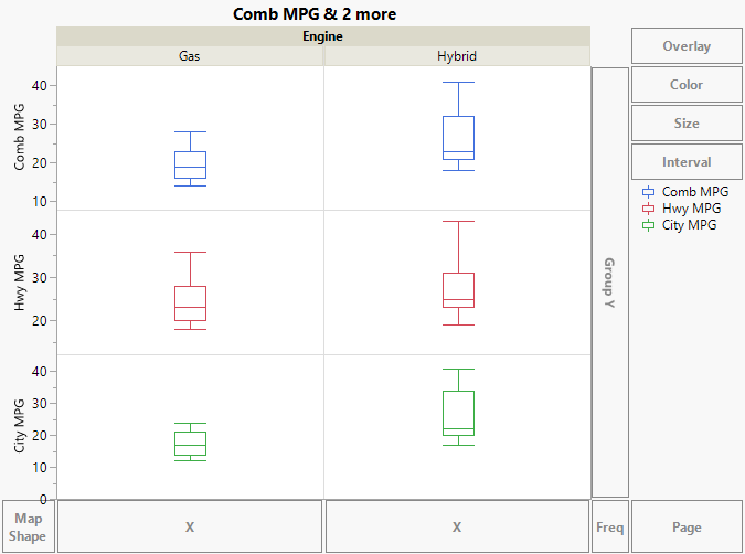

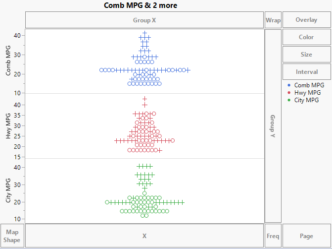

2. Select City MPG, Hwy MPG, and Comb MPG.
3. Hover over the Y zone, hold down the Shift key and click in the Y zone.
This creates separate Y axes for City MPG, Hwy MPG, and Comb MPG.
Figure 3.6 MPG Variables with Separate Y Zone Axes
In the legend at right, markers are colored according to the driving type.
Tip: To change the color assigned to a driving type, right-click the marker in the legend.

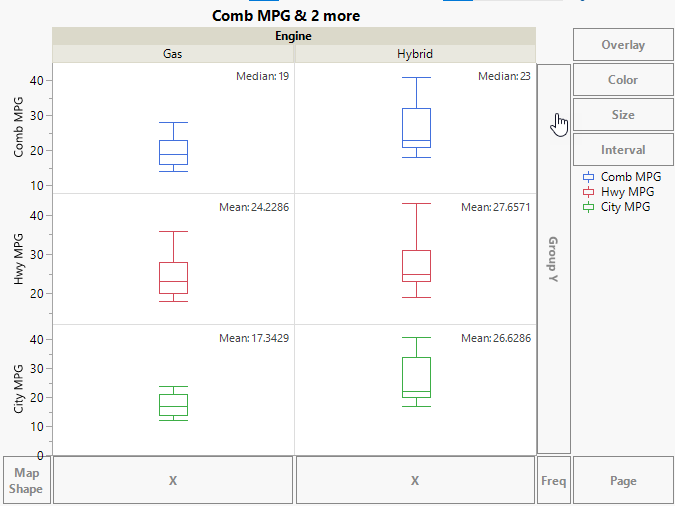

4. Drag Engine to the Group X zone.
5. Click the Box Plot icon Image shown here.
Figure 3.7 Box Plots of MPG Variables by Engine Type

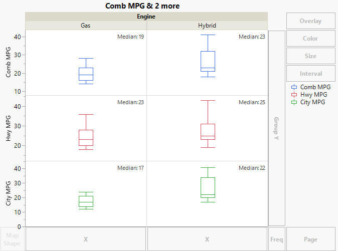

The box plots show the distributions in a very compact form. You can see that all three types of MPG values are substantially lower for the gas vehicles than for the hybrids in the study. From the horizontal lines in the centers of the two City MPG box plots, you can estimate that the median difference is about five miles per gallon. However, you can use the Caption element to be sure.
6. Click the Caption Box icon Image shown here.
7. In the Caption Box options at the left of the plot, select Median from the Summary Statistic list for Comb MPG, Hwy MPG, and City MPG.
Figure 3.8 Box Plots of MPG Variables with Captions
The median city MPG for gas engines is 17 and for hybrid engines is 22.

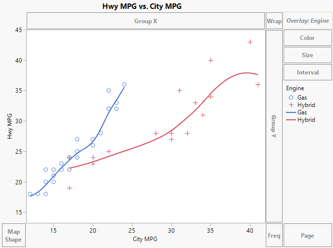

2. Select City MPG and drag it into the X zone.
3. Select Hwy MPG and drag it into the Y zone.
4. Select Engine and drag it into the Overlay zone.
Figure 3.9 Hwy and City MPG by Engine Type
A Smoother appears for each type of engine, Gas, and Hybrid.
Tip: To change the line properties (color, width, and so on), right-click a line in the legend.

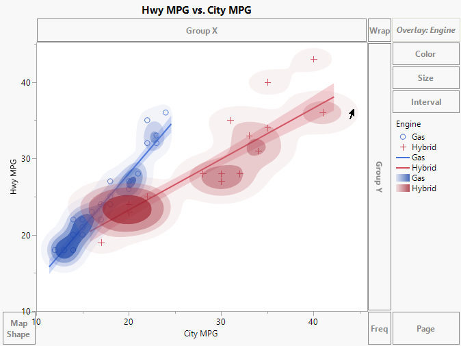

6. Drag a rectangle around the “o” marker with the smallest value of City MPG and check the number of rows selected in the Rows panel of the data table.
You see that two rows are represented by this marker. You can check that over-plotting happens for other markers as well. When there is over-plotting of observations, namely when several observations are represented by a single point on a plot, density contour plots can help you see the density of points.
7. Drag the Contour icon Image shown here into the graph.
Dragging the Contour icon into the graph retains the Line of Fit for each engine type.
Figure 3.10 Density Contour for Hwy and City MPG by Engine Type
The contours indicate that for both engine types, there are more vehicles in the study with lower MPG values than higher MPG values.
