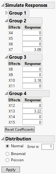

Figure 28.2 Simulate Responses Window
The Simulate Responses window shows the settings that were used to generate the design table. Note that the section box for Group 1 is closed. Group 1 contains the “fake” factors. These are all set to 0 as they are assumed to have no impact on the model. Your values might differ from those shown in Figure 28.2. This simulation has one active effect per group.
Tip: Use the Simulate Responses Window to enter new values for a different simulation.

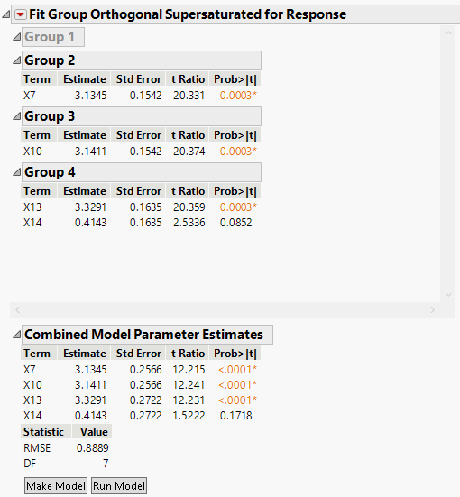

Figure 28.3 Fit Group Orthogonal Supersaturated Results
Your simulation set X7, X10, and X13 as factors with effects. The Fit GOSSD procedure identified those three factors as significant. In addition, case X14 was also identified. In practice, you would need to determine whether the size and significance of the effect warrants further attention.
Note: Your simulation results might differ from those shown in Figure 28.3 due to the generation of random results. You might see an alert that a group has one or more additional effects that might be active. This is a limitation of a supersaturated design; your findings might not be conclusive.
5. Click Run Model to run the identified model.
