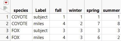

Example Using a By Group
1. Select Help > Sample Data Folder and open Animals Subset.jmp.
2. Select Tables > Transpose.
3. Select subject and miles and click Transpose Columns.
4. Select season and click Label.
5. Select species and click By.
6. Click OK.
Figure 6.16 Transpose Using a By Group
The transposed table contains values that have been transposed in groups.
